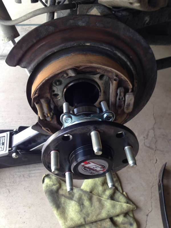

I bought the 10 Factory shafts after going through 2 sets of stock shafts. I can replace one side in less than 30 minutes now that I have done so many times. A cool trick is to flip your rotor and slide it back on your lug bolts and take 3 of your lug nuts and screw them back on turning each one until it is halfway on. Once on this way you can use your rotor as a slide hammer and your axle with pop out. Make sure you tilt the side you are working on slightly higher than the other side to keep diff fluid from leaking out. Also make sure you are careful with the speed sensor and don't strip that little 8mm bolt.
