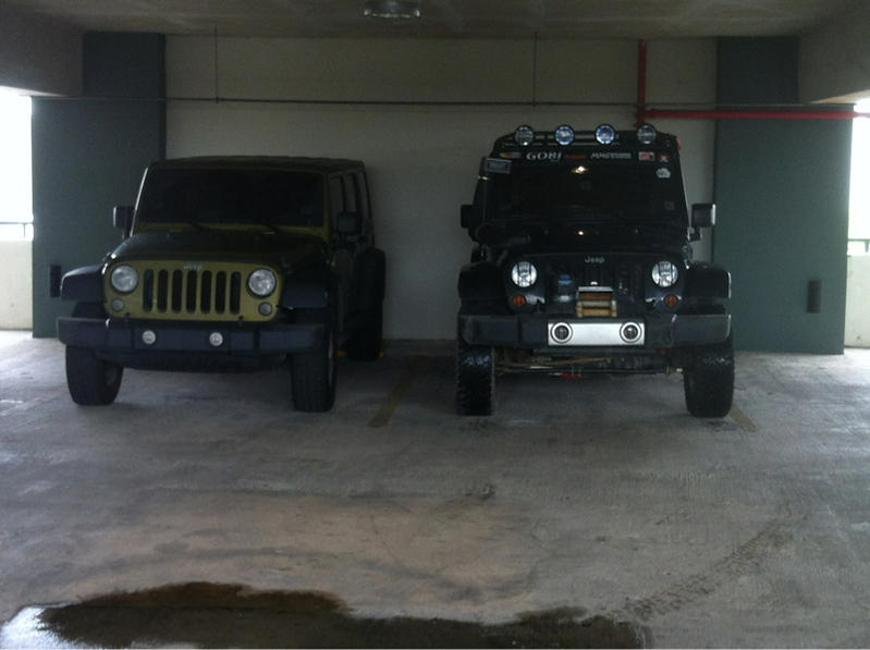

Can you guess wich one has the bent c and on what side? Pic just taken right now.

How does it affect handling/driveability if the C's are bent anyways?
Old May 3, 2012 | 12:42 PM
rickster's Avatar
Joined: Feb 2010
Posts: 347
From: Puerto Rico
Tire wear is very uneven. And I think that the bended C has lead to broken Ball Joint wich then has lead to a harsh ride.
Attachment 312237
drivers side of the black one?
