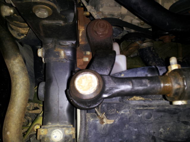

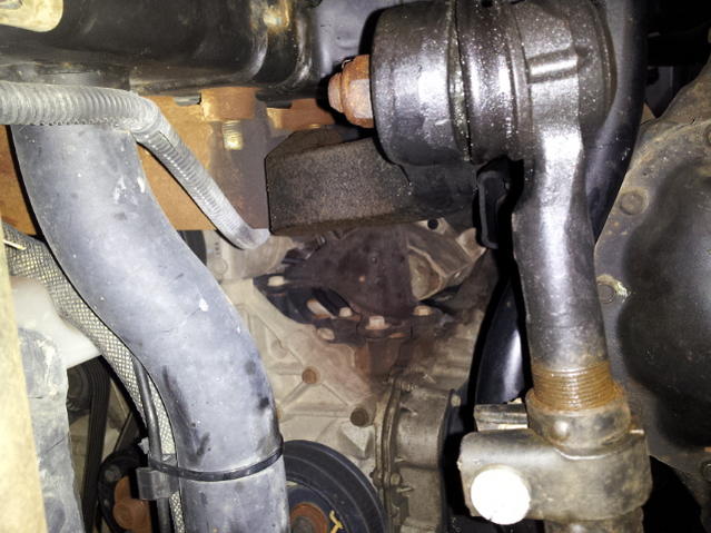

Apparently the weakest link in my steering is my Pitman Arm. I was making a slightly legal U-turn when I hit the curb with my right front. Pretty hard jolt. Then I noticed I had to steer left to keep it going straight. ESP going nuts rest of way home. Get home, and my drop pitman from my 4" RC lift was pointing left. I've got steering back to center by adjusting the drag link, but obviously this isn't a permanent fix. I've had some decent play in my steering for awhile as well, before this. My question is, is it now time to redo the steering box too? Or should I just brace the sector shaft and get a new pitman? I'm at 50K miles.
Anybody have any recommendations for beefier pitman arms? We don't get to play in rocks much here in south Texas, but if I'm replacing, I want overkill. I'll probably replace the drag link as well, since it has seen better days.

Caster is at 5.5 due to my lower control arms. Adjustable track bar was to recenter axle.
I've never had bump steer, and still don't. I was simply asking if, since I'm going to be pulling the damaged pitman off soon, should I go ahead and get a sector shaft brace?

Pictures to show the bent arm.
