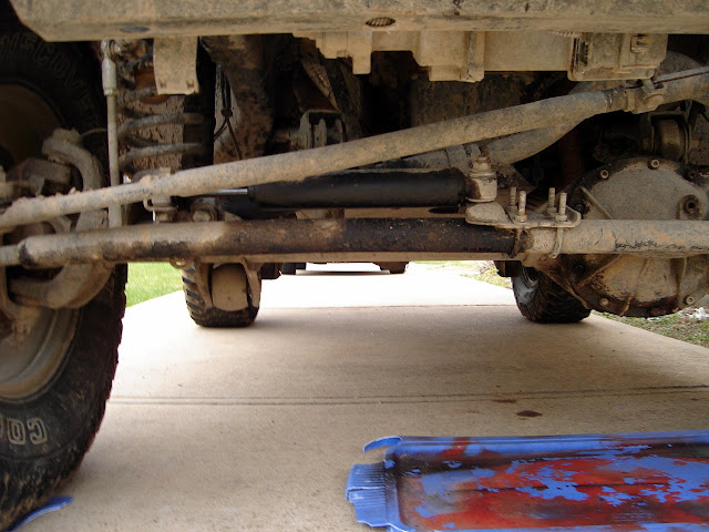

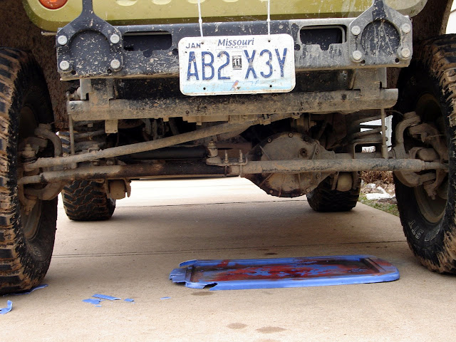

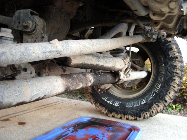

I was out the other day on some easy/moderate trails. At lunch I decided to to a mid day inspection of the under carriage of the Jeep. I found that I bent the Rock Krawler Tie Rod. Let me say that I was not racing or doing anything to extreme ( no high speeds or jumping or super large rocks). Let me know if you think the bar is bent and what should I do to fix the problem.

hard to say for sure as from the photos - for me, it just looks like it's rotated up. have you tried putting a long straight edge up to it? something a long carpenters level might help you to determine if it is in fact bent. and, if it is, that would be the first i've heard of it.

well, in all fairness, i do understand where they are coming from. if in fact your tie rod is really bent, it's not very much and honestly, it's really not that big of a deal. reset your toe and you should be fine.

potentially, yes, however, what are your realistic options here? go back to stock? of all the tie rods i have seen for the JK, the RK is the beefiest and strongest and if you really bent yours, i can only assume you did it having a lot of fun on the trail. i know it's not the answer you want to hear but really, you should be just fine with what you've got.
