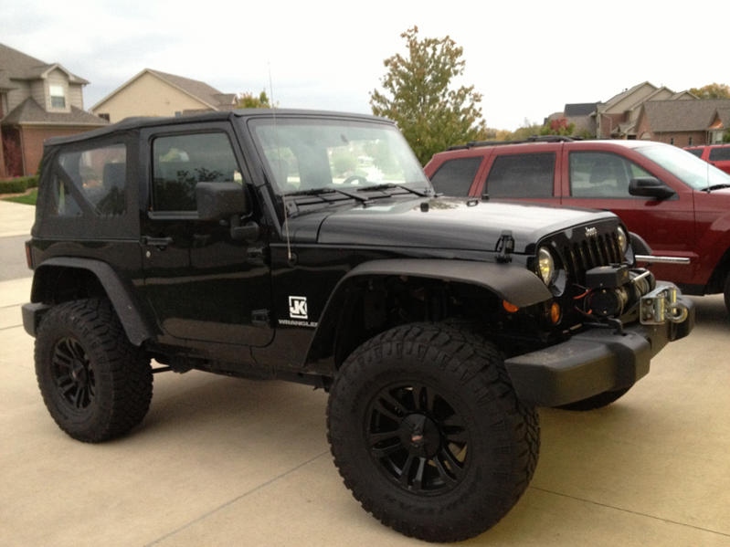

I currently have 35" good year wrangler duratracs on it and they fit fine especially with the flat fenders. If you have any questions let me know I would be glad to help!
Oh and as for wheels... I have Rigged Ridge Satin Black 17x9 with 4.75" BS and love 'em. Consider checking those out in addition to the XDs (which are also pretty nice)
