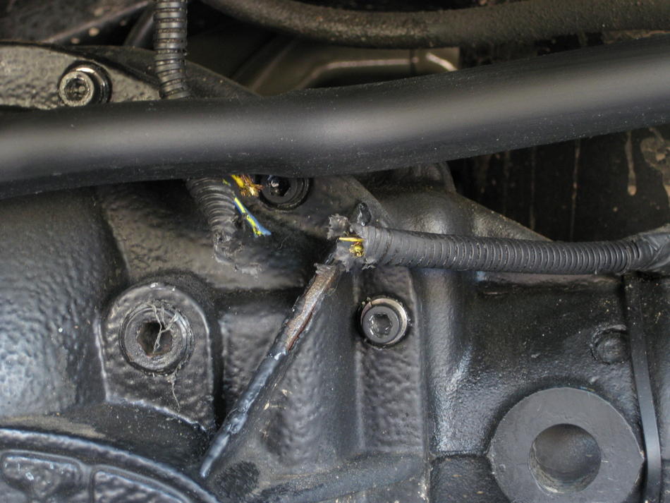

Originally Posted by hitekrdnk43
Solids were on sale for $65.00 or so each over the summer and maybe still are (check their website). It almost got them, but I had read that some people had rubbing issues with their stock track bars so I opted for the Riddler's.
I've got SOLIDs. Before adding a JKS rear track bar (was running OEM TB + frame side drop-down bracket), I got interference which resulted in a severed e-locker wiring harness 12,000 feet up on Wheeler Lake trail south of Breckenridge.
IMO, ARB covers are overpriced and the dipstick and magnetized drain plug are superfluous. I do like the fact the covers feature counter-sunk bolt holes, however, as I've ground an allen or two down to nothing during one long day on the trail.
Had to do over again, I'd buy Riddler covers. Stout nodular iron, (mostly) protected bolt holes, no fins or sharp edges to hang up on and less costly than ARB.
FWIW

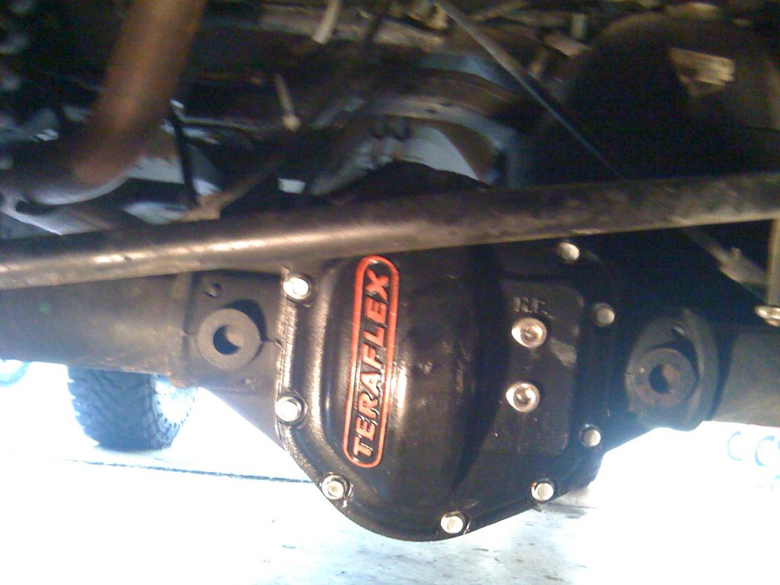

I like my TeraFlex ones!
Attachment 88157
X2 Great covers

Teraflex! Teraflex! Teraflex! They look good and hold up great. Of course almost my hole rig is Teraflex.
