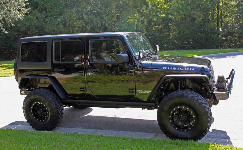

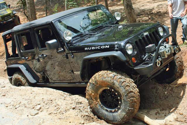

Stock arms, steered fine for 40k miles as my DD... and not cranking the caster to 6 degrees with LCA's allowed me to run my stock driveshaft without issue.
