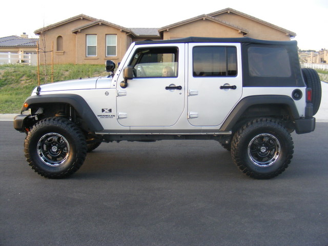

Default Here's what you need:
A 3" Teraflex coil spring lift and rims with 4.5" backspacing. I just lifted mine this week. Eventually you will want to change your stock gears as well. I am going with 5.13's with an automatic. You don't need to change the drivelines unless you go wheelin with the front disconnected.
