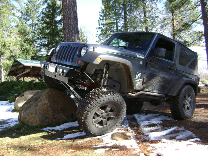

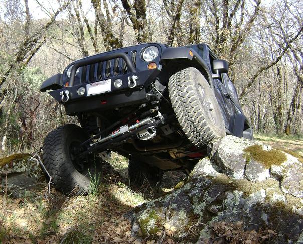

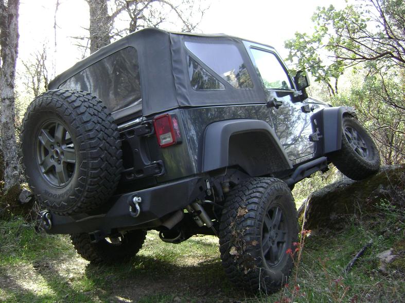

the EVO plush coils ride great and flex awesome.
