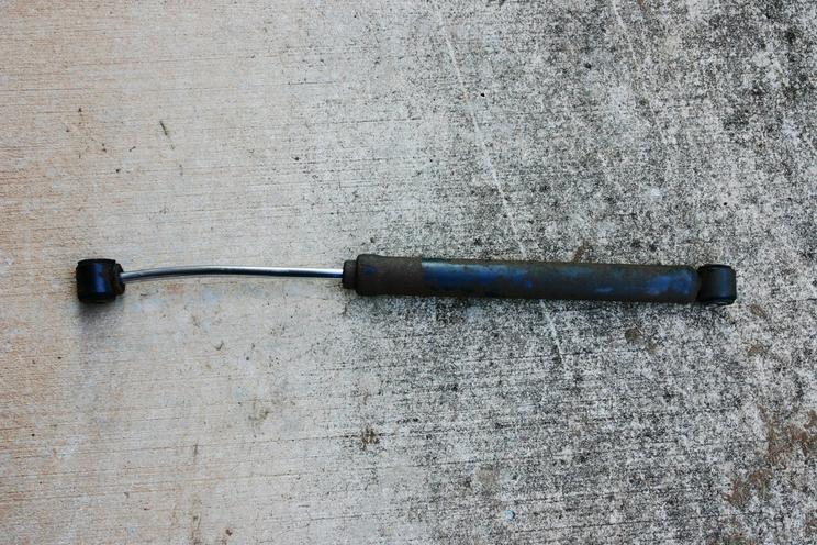

This is what did and didn't work for me. And please bear in mind that my Jeep, at 137K miles, drives straight as an arrow and has great steering feel (click on the signature link to all of my mods). There is no DW and there is no bump steer. I can and have driven without the steering stabilizer when mine bent, and could not really tell the difference. I did relocate the SS with the JeepSWAG kit very early on.
The OEM SS, after relocation, did not work well. I found it bent after some hard crawling at Disney, OK ...

I've had to replace the Teraflex because it started seeping oil. Still worked fine, but just would dribble a little oil under the vehicle. Have never bent one, nor had one lose pressure.

Just a question, what bumpstops do you have in the front ?
I red that it requires at least 2'' bumpstops in the front with a stabilizer relocation bracket.
Is it possible your stabilizer shock hit the frame ?

It certainly may be possible. Back then I had the RC budget boost with RC shocks, I'm pretty sure. And Disney does demand some pretty good articulation. Now I have a TF 2.5" coil lift, which came with bump stop extensions.
