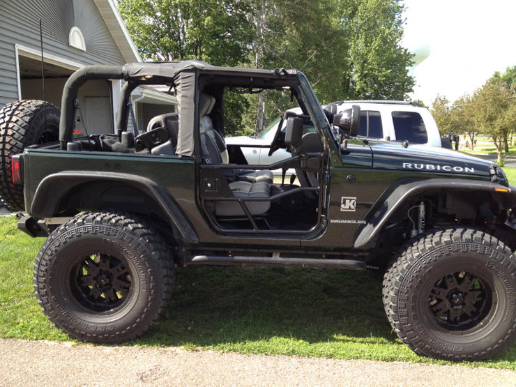

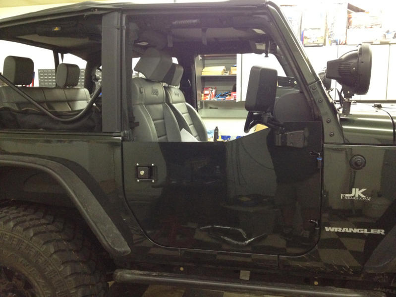

Recently purchased the Bestop Element Door package.
RockRails, Painted Matched Outers, Door Bags and Upper window enclosure.
I'm somewhat satisfied with the product except for the latching mechanism and sealing of the door

That's the complaint I have so far is the latch mechanism and the sealing quality.
My friend who is an engineer is looking at the latch motion which he states it travels to far within the latch allowing it to rattle
Nothing to do with adjustment on the strike plate or latch on the jeep side

The door when latched rocks inward and outward and rattles. The latch inter mechism moves upward and needs to be limited. I am going to tackweld a small piece of flat metal to restrict the movement and try that out.
