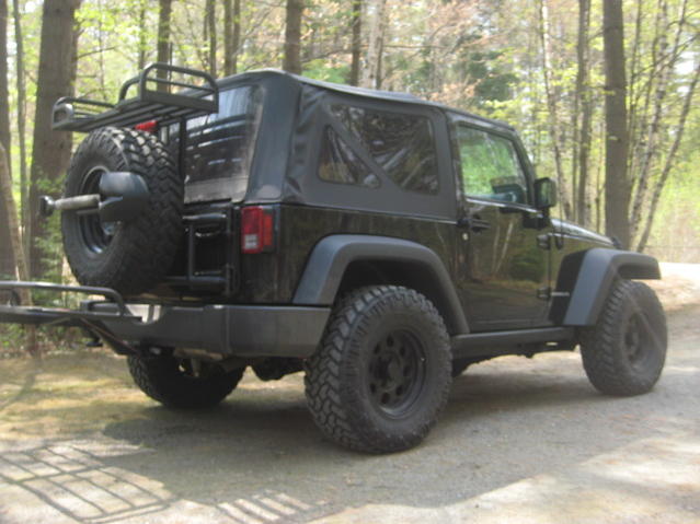

Default and 33s are
31.5 lol but i like them 40,000 miles and still going strong
i had 35" km 2 on my truck and they prematurely wore out i feel
the nitto tg are heavy though
