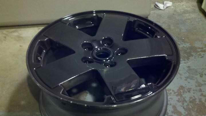

I also have 18" and I powder coated them I wanted to go 35" on my stock wheels, but after some research I also noticed that it would be the same price (35" on 18") as (35" on 15" with aftermarket wheels!) So I went with the 15" and when going off road it's much better, less wheel to scratch.
