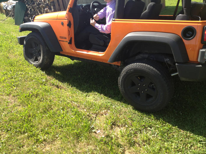

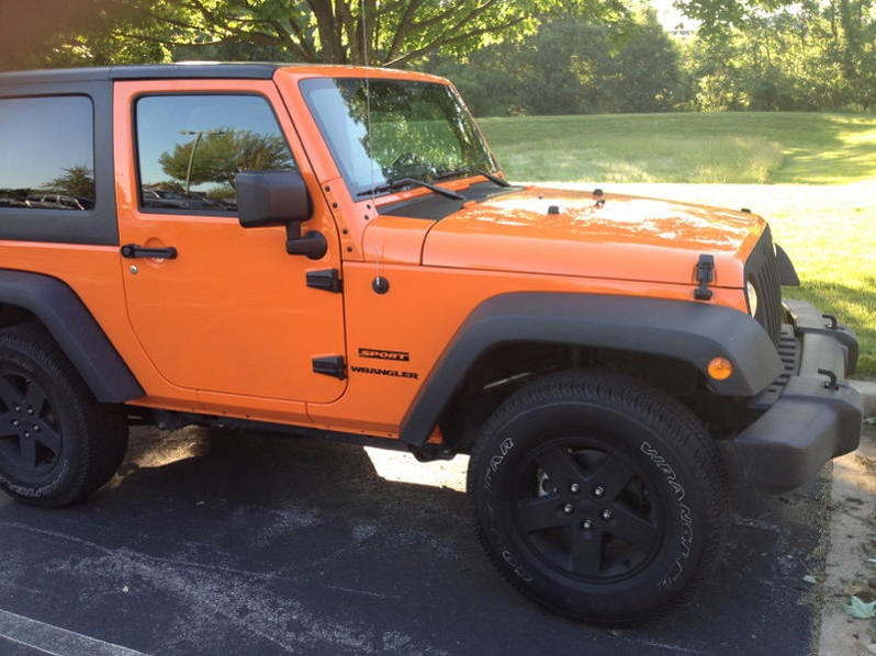

Love the look. Used duplicolor self etching primer and low gloss engine enamel after hours of scuffing and prep

Plastidip is far easier, but I took a more permanent approach. Don't waste your time taping either way. I took wheels off and just sprayed. Paint will flake off the tire within a few weeks, and plastidip overspray will peel right off tire once it dries.
