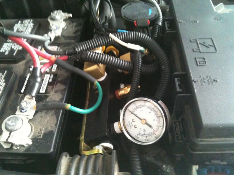

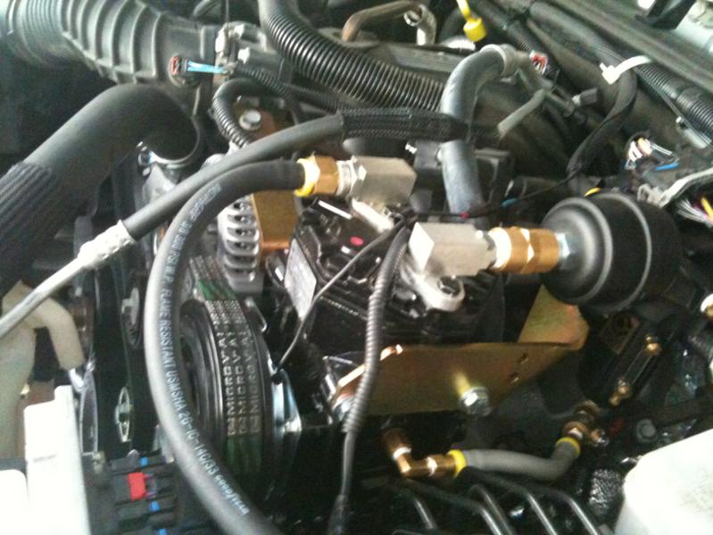

I have the Kilby OBA setup, and holy he'll does it rock. I can fill a 37" tire from 5 psi to 30 in about 2 mins. It is powerful enough to run an impact wrenches with ease. Air horns would be cake. The install is a really easy as well. It comes with a 2.5 gallon tank, but I'm sure they can get you bigger if you want it.
ID:	104772   Click image for larger version
Old Nov 24, 2010 | 01:50 PM
09GRNJK's Avatar
Joined: Mar 2009
Posts: 317
From: San Diego, CA
Whoa
Is that belt driven??

Originally Posted by 09GRNJK
Whoa
Yep, uses a york belt driven compressor. Nice setup, but it's also over a grand.
$1250, to be a bit more precise...
