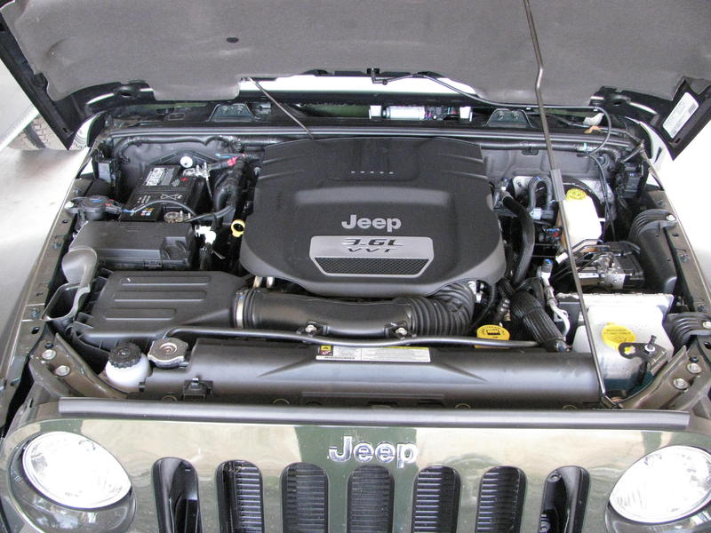

If anyone has a 2012 I don't think you can mount one under the hood, as there is zero room. Just fyi.
Name:	2012 engine.jpg
