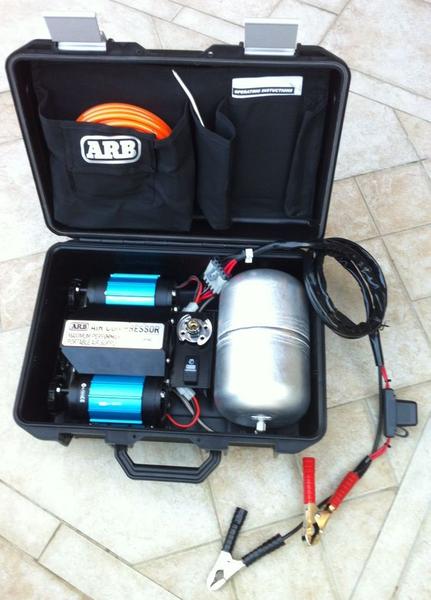

The ARB are well tested & proven world-wide, and are among the most reliable compressors one could get.
Mine works fine inflating 35"s even in desert conditions, around 40 Celsius (104+ F) ambient temperature.
If you're after real quick tire inflation, get the twin-head. It's basically two ARB compressors mounted together, so there're two pistons and about double the airflow.
Some install them in the engine bay. I wouldn't. I don't see the point of "cooking" a compressor in such a hot place, or having it suck hot air, or being exposed to water, mud and dirt.

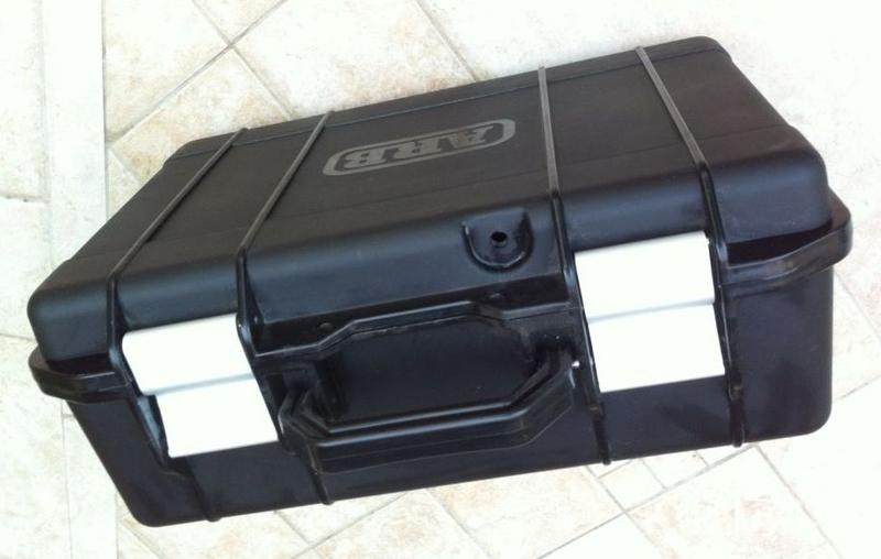

I keep the ARB at the rear. I had a fixed one, sold it with the Jeep, and for the current Jeep I got another ARB, the portable Twin head. I find the portability to be more convenient.

My ARB airs up four 35" tires continuously. It doesn't need duty cycles.
It "rests" only for as long as it takes to move the air pipe from one wheel to another, which well under 30 seconds.
