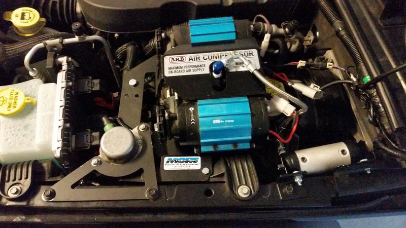

Here is the compressor with vacuum pump relocated and manifold.Click image for larger version

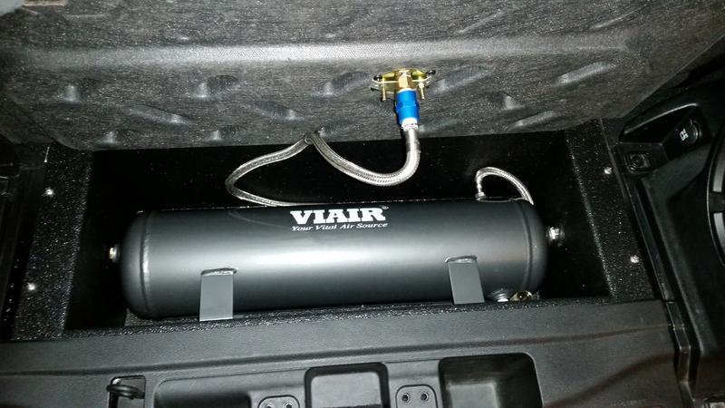

Here is the custom rear tub enlarged, Line x'd and tank installed.Click image for larger version

Here is the compressor with vacuum pump relocated and manifold.Attachment 598574
The vacuum pump wouldn't work there with the SPOD source system if thats what he will use for his switch system.
Did the air fitting clear your hood?
Yes. M.O.R.E supplies the 1/4 npt elbow. The braket is a perfect fit in that location. And yes, the vacum pump relocation will not fit in that location if an Spod is used. I also modified the M.O.R.E plate so the pump could remain there. I highly recommend their plate and their service and shipping is outstanding.
