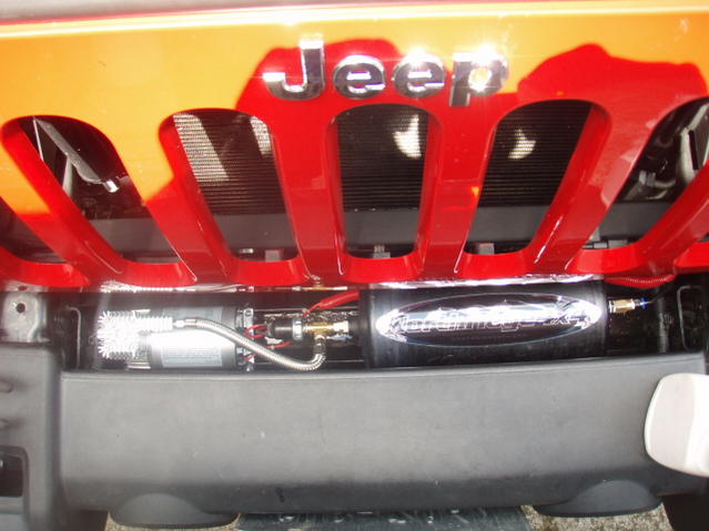

Just put one in for my air horn.
Vair compressor and a 1 gallon tank.
Installed an extra air chuck for tools, etc...
