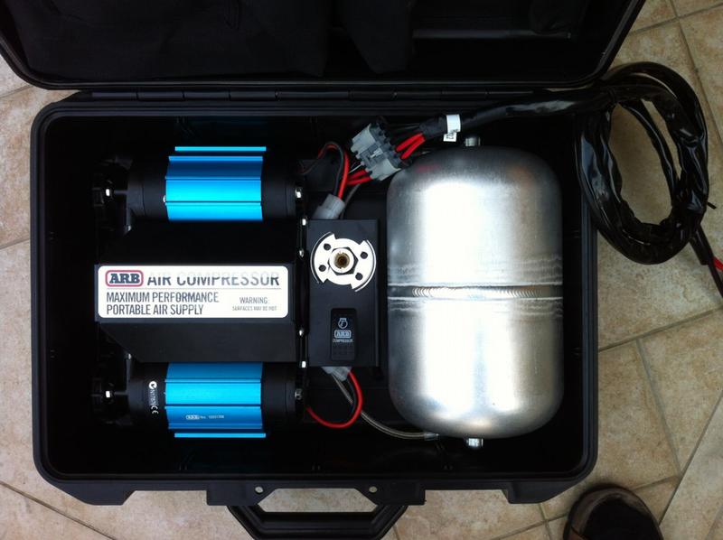

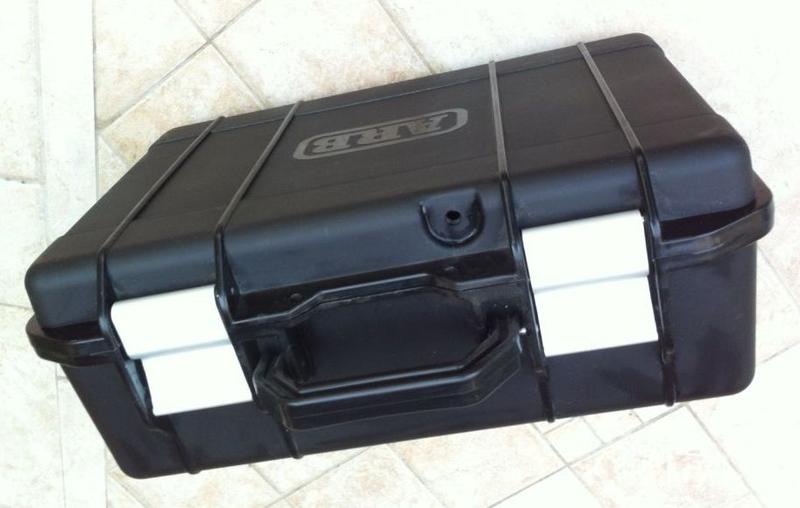

I wouldn't "cook" a compressor in the engine bay, or let it suck the hot air.
For operating tools and fast inflating, a twin-head compressor is the answer.
It's the second Jeep in which I use the ARB twin head. One of the most reliable compressors, and probably the smallest.
I use a pneumatic impact wrench and a cutting disk -- works real nice.
In the previous Jeep it was installed in a frame, with the air tank on top. The air tank was made from a fire extinguisher...
This time, I got the portable twin ARB - everything in a case:

The portable case allows more freedom in arranging the storage space.
I plan to add a thick wire directly from the battery to the rear, so I can connect the compressor to a socket.
