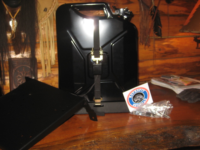

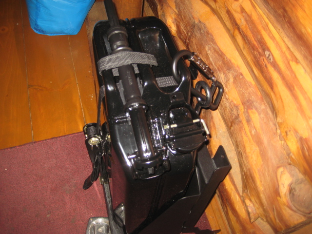

Default Another option is this that i chose
iI just received mine . Its 20 degrees out side and road salt eeverywhere so not on my jeep yet or any rush but cool item ( This will work as multi use for me )
side mount jerrycan holder ( *can not included ) Retrofit~offroad
https://www.youtube.com/watch?v=_PffS7O6-Q4
https://www.youtube.com/watch?v=e9dKmBW5xY0
$ 159.00 but its definitely cool and can hold tools or amo box , water container , rotopax whatever or as he displays a shower if water cans or roto pax are your choice
