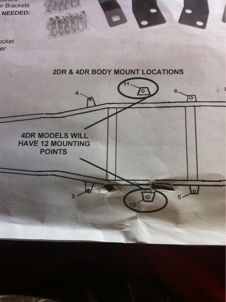

Installing a 1 1/4 body lift and running into minor problems. First, the passenger side 18 mm bolt in the center of the mount backs out almost completely but spins freely. I cannot get the bolt to come off. I have taken the center bolt out on all but the center ones. Any one else have this problem?

. The diagram shows two mounts to the rear of the engine but I'm not seeing them.

.....Jeep has changed a few of those body mount location throughout the years that I lost track of it. As long as you don't physically see those body mounts you should be ok...

Default 10 mounting points
I just checked the mounts on my 2012 and it has 10 mounting points
-The front
-At the end of the front fender flare
-In between/middle of the front & rear doors
-At the end of the rear passenger doors
-At the end closest to the rear bumper.
**** I did see a cut out/hole that would have been a possible body mount just right next to the rear coil springs. If the mount was there that would have been the 12th one *****

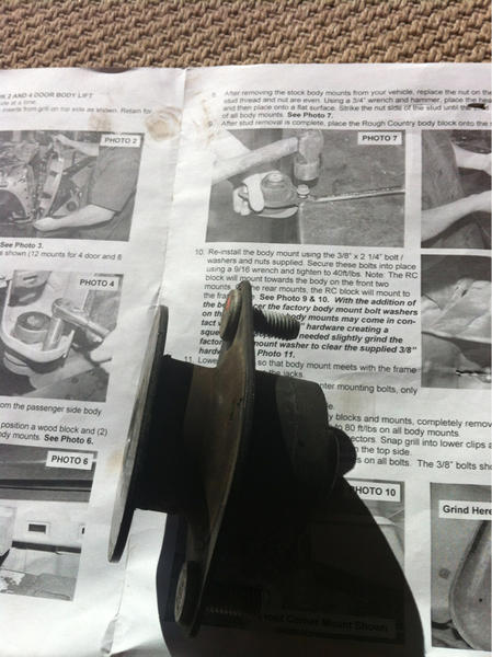

Did u have any issues getting the existing 2 bolts off? I need to pull these and out in the longer bolts with the pucks on top but having a tough time getting these bolts off too now

The MORE BL is different. If you look at the first pic it shows (2ea) new black body mounts that is already spaced 1" and replaces the entire part you are trying to work on. See if using a Heavier Hammer will help as you pound out the bolt....
<img src="https://www.jk-forum.com/forums/attachment.php?attachmentid=381638"/>
Thread the nut back onto the bolt until the bolt is flush with the nut, don't have any threads sticking out past the nut, then get a 3/4" combination wrench and put the boxed end under the part that is pressed in either on the flat surface of a vise or block of wood then get a big hammer and hit the nut until the bolts come out. It's a pita cuz they are so many. The.instructions show how to remove the bolts, I can see it in the last pic u put up
