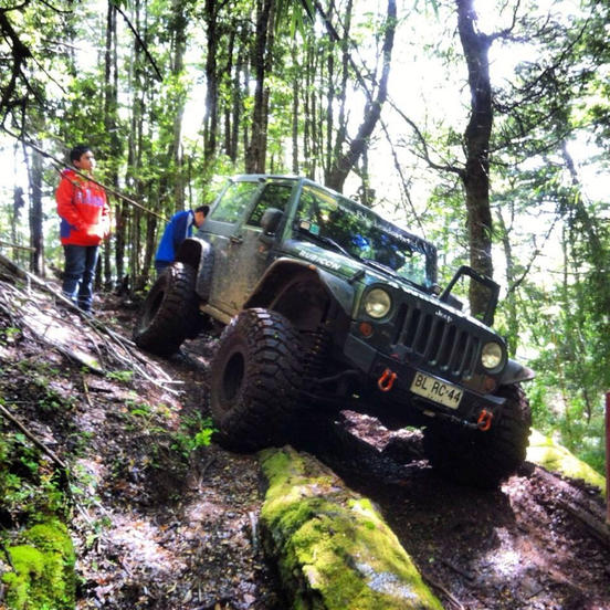

Hi Guys,
I have a rubicon 2009 3.8 with a few modifications.
The problem is after instal borla headers inox appear in my dash "check engine"
Obviously is for O2 sensor.
Someone fix this?
Regards
