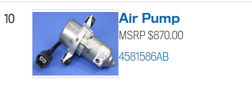

I don't disagree with that idea at all, but it kinda seems like maybe one of those easier said than done things. I've been under the impression that the pump is only really working when the variable timing isn't producing enough engine vacuum. Am I wrong or is that operating 100% of the time? If it is only working part of the time, then how would you get that to be on all the time to make use of it? Also, I presume that would require knowing what kinda vacuum this pump is creating and then finding some other alternative that is capable of producing more vacuum and then wiring that in instead? On a side note, I really had no clue that OEM pump costs so much -

Resharp - yes there is vacuum when running on 8 cyls but the vac lines run only from the pump. Not sure of the internal cutoffs but it is on 100% with engine running. It is about the same size as a smaller AC compressor and bolts to oil ports on the block. I agree it may take a bit of investigating to see if this excercise is worthwhile as one has to find a better more suitable electric pump. Price of Mopar part
