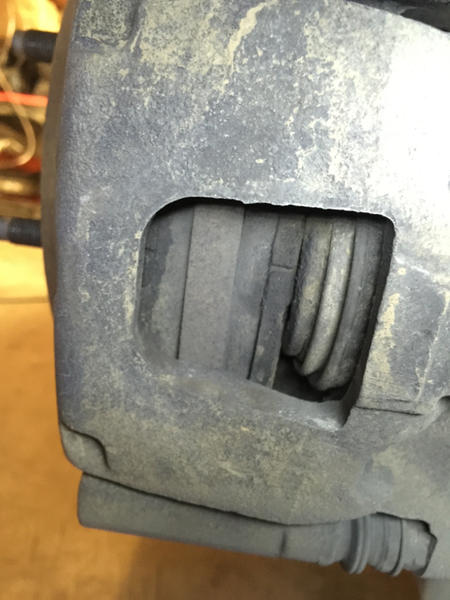

Rear brake pads in photo, are they worn? The fronts look about the same... Still having the brake light solid light on dash... Turns off when driving turns on when stopped.

The light isn't flashing like the e-brake light it's just solid.... From the photo I posted can you tell if the brake pads are worn? First timer
