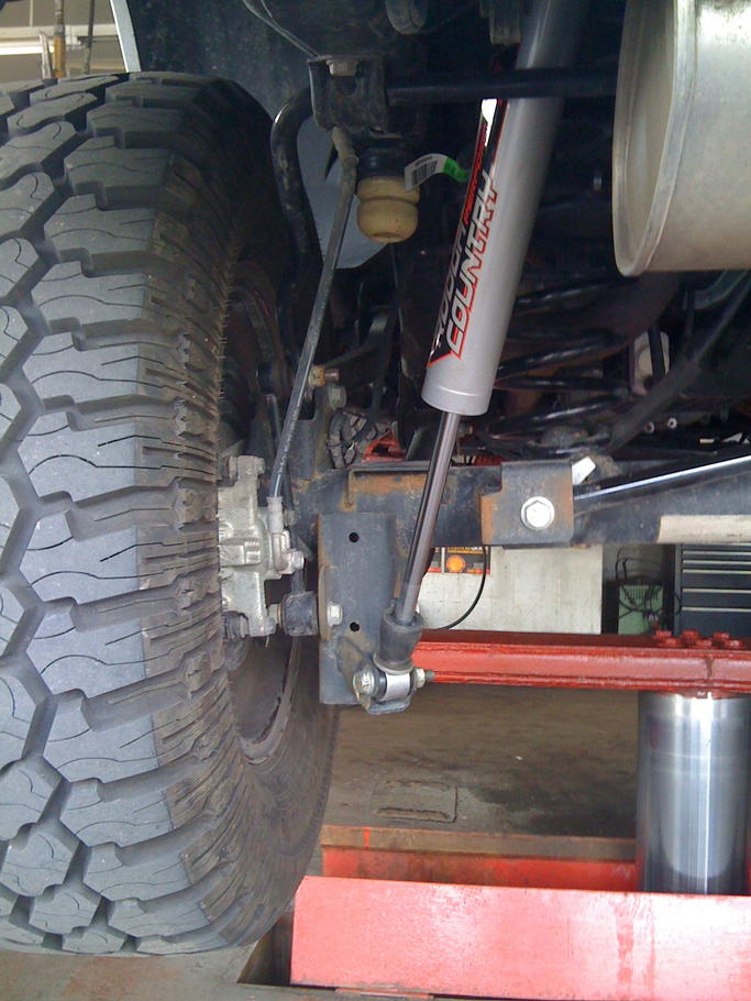

Guys,
I've installed my RC BB wt shocks and look at my brake line in the rear when it's on the lift... Do I need a relocation bracket ? Is it stretching to much ???
TKS !!!

Oh yea!!!!!!!!!! That puppy is about to pop!

is that axel fully extended?
you might be able to get away with just fleximg the metal part of the line down a little.
but yes the safer and more reliable solution would be an extention

I don't see much that catches me off guard at first sight, but that did. I would change that ASAP.

For the time being just unhook the brake line from the frame and keep it on the road till you get new lines or a relocation bracket. Like the one teraflex carries..

You can make them for cheap...
yeah, it's up on the lift....

Absolutely those lines need to go, or be moved

Yep, a buck or two at a hardware store and ten minutes of your time--before you go wheeling again!

I am installing the 2.5" TF coils on my JK this weekend and I thought about getting new brake lines but it seems this process works. Just by dropping the bracket a few inches, I am going to get the needed extention so I don't snap a brake line? Is this just a cheaper alternative to upgrading brake lines?
