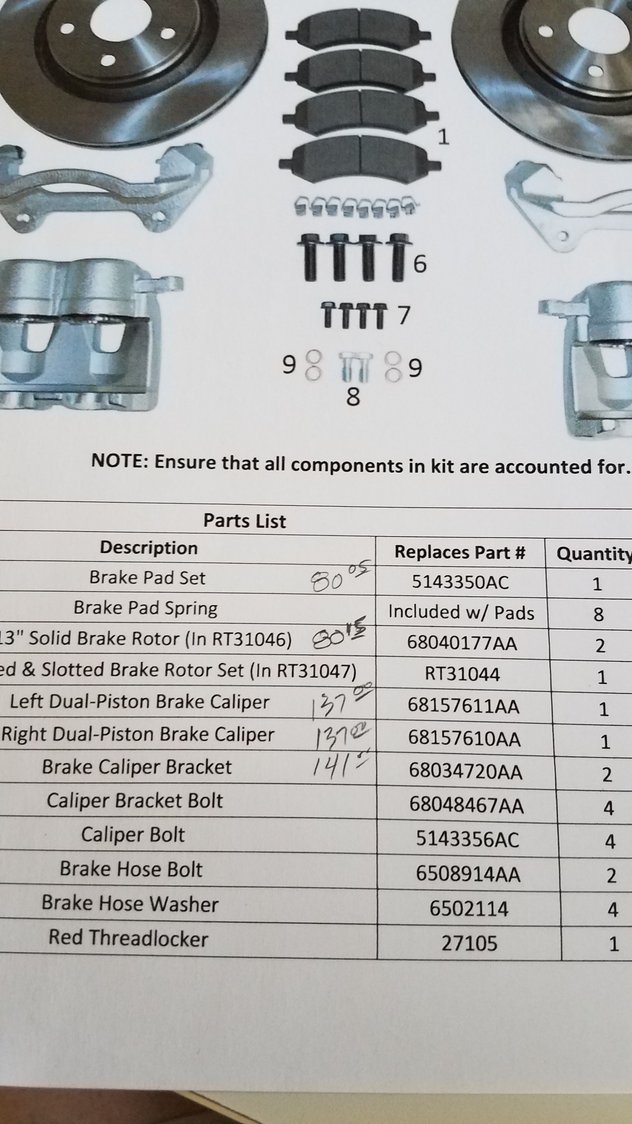

Resharp I am wondering about your comment re "the 3.8 MC"? Is it the lack of vacuum from the engine that makes it not as good or is it a totally different MC on the 12+? The reason I raise this is my 2008 (obviously a 3.8 once) has much improved brakes with the Chev engine driven, oil lubricated vacuum pump and has vastly improved the stopping power for this Jeep. I was planning the BB kit for the front. And awesome news that the RAM 1500 forms the parts lineup for this. Does that mean the longer caliper mounting brackets from the RAM fit the Jeep?

It's been a long time since I've researched/read up on this, but I generally recall the MC bore size increasing with the model/engine change. This is also the reason TF used to say if you were doing their BBK for an '07 - '11 you should do their MC, but it wasn't really required for the '12+. I could not tell you the actual specs off the top of my head, but I'm sure they are floating around out there. There is also a thread out there where someone, maybe Rednroll, had all the part numbers to piece this kit together. It seems that the caliper brackets were not directly off the Ram 1500, but I could be wrong about that one. It's been a long time since I've gone down the "brake" rabbit hole. Karl might recall some of this, maybe. I'll see if I can locate that thread.

The Crown BBK components and MOPAR PNs.. Kit purchased from Quadratec..
