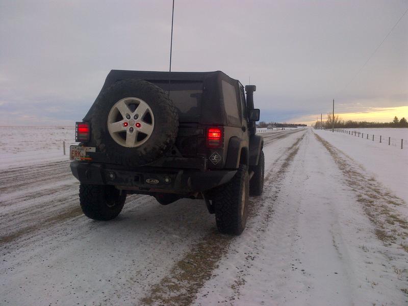

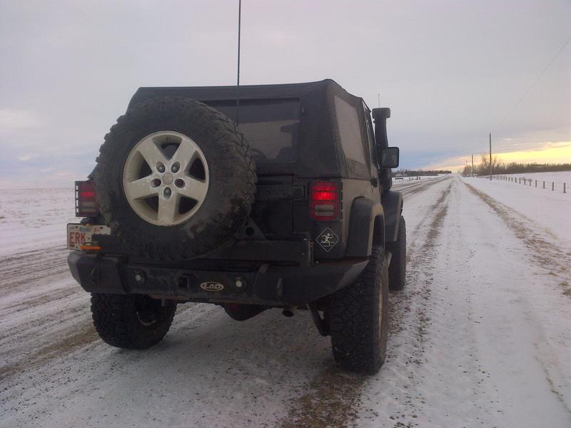

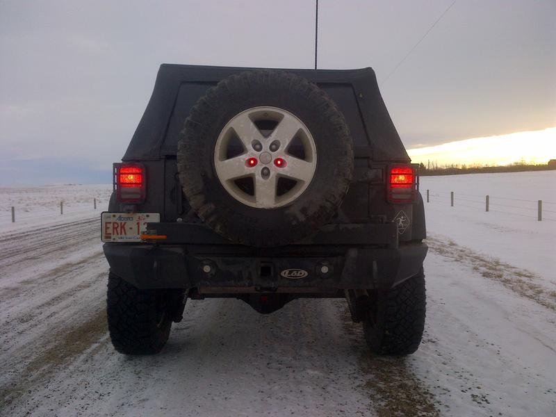

Don't have the license plate relocated but do have the brakelight moved.

I like this. Simple clean and effective!

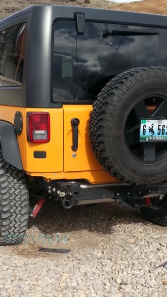

I got that kit from Northridge, if you have a sub woofer, it's a pain to take the sub out to wire it up nice, no complaints. But use the white wire with brown stripe under the black panel on the tail gate for the third brake light.

not bad. three bolts hold it in. two on the bottom and one by the seatbelt on the roll bar. there is a plug on the top corner and run the wires down the rubber grommet. i used the blue splice things to splice in the wires
