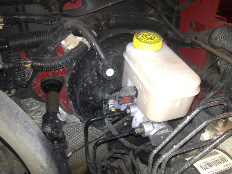

I had to replace the front brakes last year and went with the Teraflex Big Brake Kit and Master Cylinder as I have a 2008. After about 500 miles the brakes became amazing! My other vehicle is a Lexus GS350 and I can say that my Jeep stops like the Lexus with Big Brake Kit. I can't imagine going back to stock brakes after this kit.
Name:	Big Brake Kit Master Cylinder.jpg
Name:	Big Brake Kit.jpg
