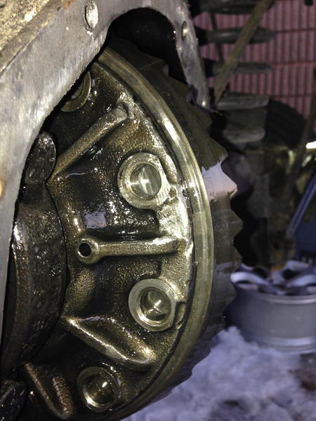

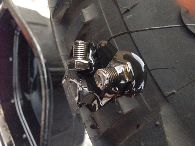

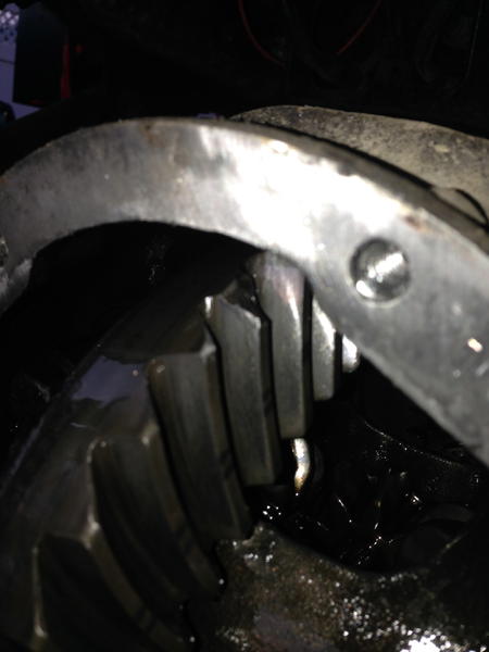

Skip Nitro Gears. The bolts ring gear bolts they supplied failed causing gear failure and destroyed my axle housing and LSD with pieces of broken bolts. No only did they not warrantee my gears they charged me full price and up charged me on next day shipping.
I'll never do business with them again. Their inferior bolts caused me $$$$ in extra damages, parts and labor.

Man. Sorry to hear that. Thanks for the info. They are off the list

So, the gears are fine? Just the bolts are weak? The reason I ask is I just bought a set a Nitro 4:10 gears and before I put them in, do I need the replace the bolt?

So what grade bolts were they? Can't tell without a picture of the bolt head. Was there play in the bolt holes? Torqued to spec un-lubed and red Loctite?

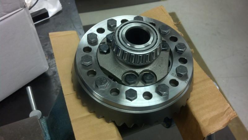

BTW, I have Motive 4.88 gears and Truetracs front and rear. Motive has been in the gear/axle/transfer case/transmission parts business for 65 years.
And no, all gears are not the same. The source of the steel used to make the gears makes a big difference in strength and wear resistance. The installer is also important. They should be experienced enough to spot poor fitting or underrated parts and correct potential problems before they become actual problems. When was the last time you heard of an installer lapping the rear face of a ring gear or even checking the run-out after installation? Does the installer give you a written brake-in schedule? Since factory components go through a break-in at the factory people tend to discount the importance of proper break-in for upgrades.
