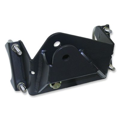

the second one you can add to the tacbar after you have welded and will beef up front...........this is from sky jacker

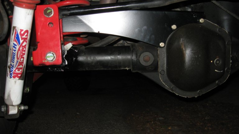

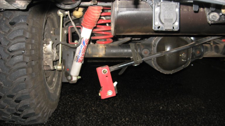

these last two are before and after pics of the rear trac bar using the sj parts, mine broke at 3a.m. on a sunday driving from virginia to georgia.....yea..
Attachment 13736
Attachment 13737
Wow, that's crazy. I'm glad my Skyjacker kit can with that brace that bolts onto the diff.

WOW, looking at the pics of the broken trac bar bracket that was definetly a design flaw with Skyjacker. Adding just that bracket to the axle housing turned that bracket into a nice size lever for the trac bar.

you'll need to have your factory bracket welded back on and you can have it gussetted up or have the JKS bracket welded on. if you need the additional relocation bracket, i would recommend the one made by Currie.
