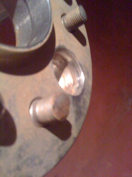

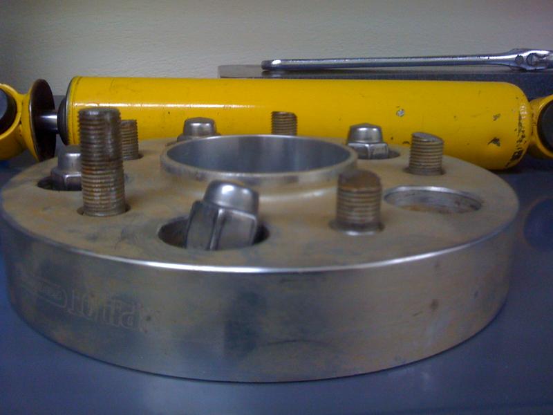

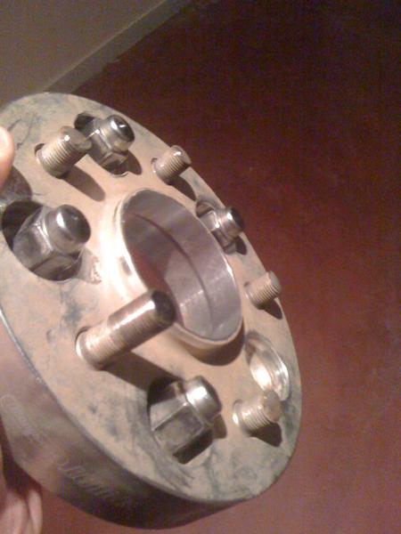

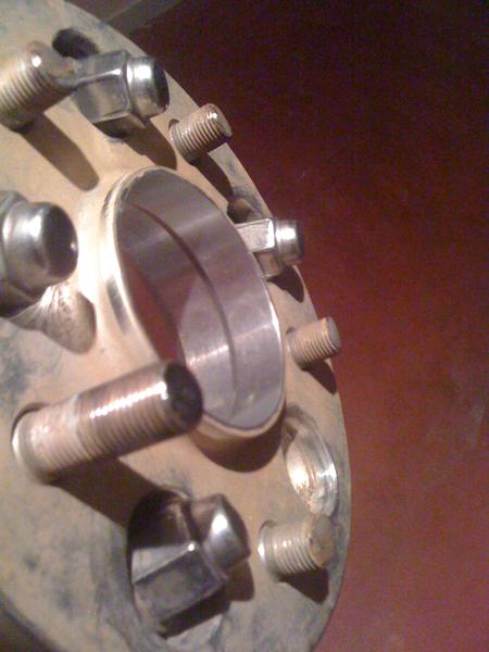

pics as requested

its called "pilot racing" its has TUV and CE certifications. It is italian made so probably none of you will have one, but i am saying just in case. I just realized that i bought crap

Originally Posted by orfanidisnikolaos
There's a good amount of corrosion on those.
It's hard to tell from the blurry closeup (use macro settings!), but it looks like a brittle shear.
I concur with the previous posters. It is sub-standard hardware coupled with over-torque (impact wrench, most likely). I would bet the bolts cracked on installation and it just took a while for them to totally fail.
You are very lucky.

Interesting to note that the spacer itself was not 'broken', but it was 4 of the 5 studs that failed...crappy metal, good enough reason to avoid that brand, if that is what they consider good enough.
