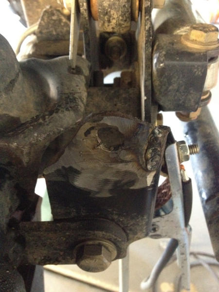

I have no idea how this happened. Has anyone else seen this? Basically, the sway bar on the passenger side of the front axle pulled itself out of the mount.

I repaired it by hammering the bracket back in shape and welding washers on both sides

Just wondering if anyone else has had this happen

Was this an aftermarket bracket?

After market sway bar link on a stock Rubicon 44 front axle bracket

What brand links? I would guess that the problem wasn't the link, it was the factory bracket.

Afterthought: are your links adjustable? And are they the right length?

There is no way that is a factory bracket, that's a relocation bracket which appears to relocate the trackbar, stabilizer shock and the sway bar mount.
Agreed, there is a lot going on there.
