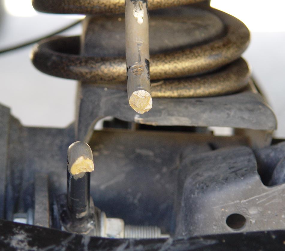

Godzilla's Avatar
Joined: Jun 2007
Posts: 22
Attached is a shot of the rod that broke on the right side
Old Dec 3, 2007 | 12:03 PM
Dayton's Avatar
Joined: Apr 2007
Posts: 596
Originally Posted by Godzilla
Attached is a picture of the left side.
Thanks for the pix.
Were you still using the factory links or did you have new TeraFlex links installed?
Did you answer Eddie's question? Are you still running factory links?
