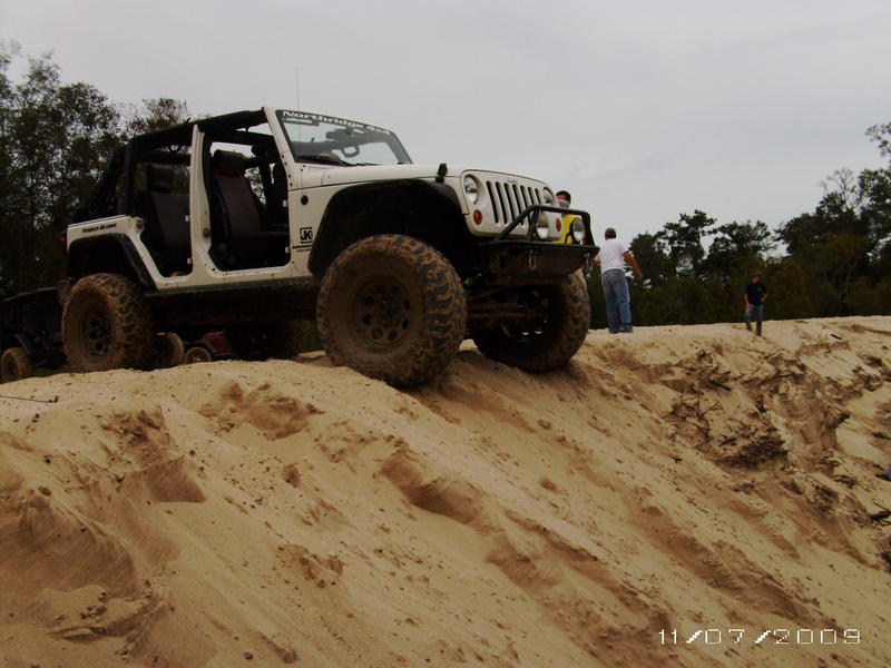

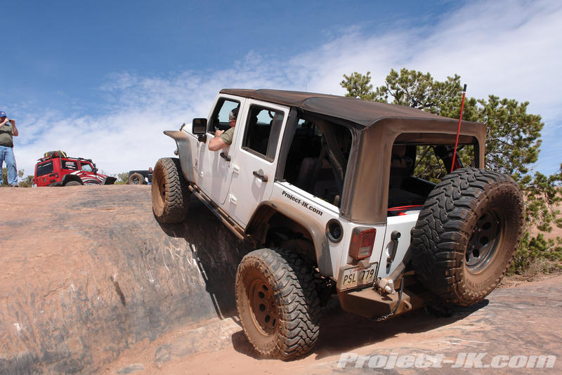

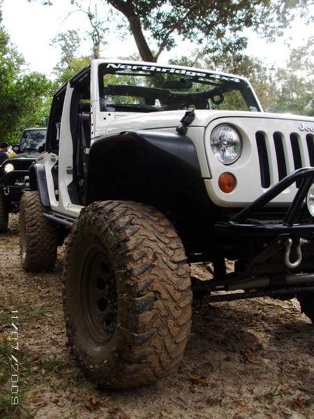

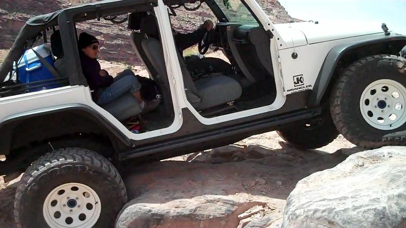

Old May 16, 2011 | 06:23 PM
mkjeep's Avatar
Posts: 15,665
From: Hammond Louisiana
ID:	161251Click image for larger version
ID:	161252Click image for larger version
ID:	161250Click image for larger version
Name:	Moab_Trip_2011_April (396).JPG
ID:	161249Click image for larger version
ID:	161248Mine hasn't shattered........yet
