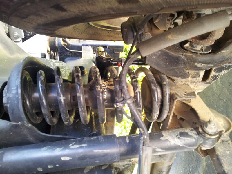

Hey everyone. I have a '10 jku with the tf 2.5 lift with shock adapters. Took the Jeep for a road trip with 4 friends and luggage, and we hit the bump stops on the freeway multiple
times. Even unloaded there is minimal clearance for up travel. Is this normal? Is there a way to improve the up travel like speed stops? Thanks.

From the earlier picture it looks like tjey really dont want you flexing up. Can you modify them any to take some length out or are they tapered all the way down?
