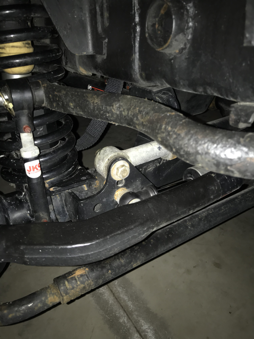

I am getting ready for my 5,000 mile road trip this summer and now that it is slightly nicer outside I am working on the Jeep again. At the end of last year I added a flipped drag link and I needed to make sure I had the correct bump stop in the front which turned out to be about 2.75". I have read a lot of posts about people having to add a lot of bump stop or notching the frame and I wanted to comment on how I came about this number and add a data point for others as a reference.

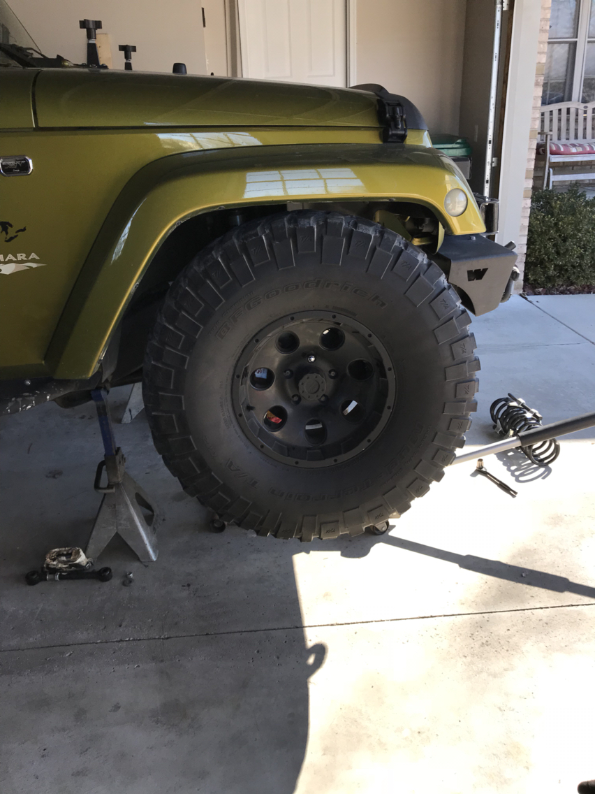

I removed both springs in the front and when I went to full stuff I was surprised to find that the track bar hit the frame before the drag link did. I suppose this would happen even if I was not running the track bar in the top position because the track bar end only protrudes about a quarter inch above the bracket so the bracket would hit the frame as well. The drag link was close to hitting but I did still have some wiggle room, sorry but I don't remember exactly how much. I have read that some people use axle side track bar brackets on stock 30/44's that do the same thing and raise the mounting position of the track bar, I am guessing that they run into this same situation where the mount hits the frame as well??
Anyway, it would be nice if I could have got away with a little less bump but I don't think that 2.75" is that horrible. I welcome any comments you may have.

Typcically you add 3.5" of bump stop and you could check it with the passenger side stuffed and the driver side fully drooped not just stuff both sides. How much lift or spacers has nothing to do with how much bump stop it is really the shock length, the longer the shock travel the more bump you need.
