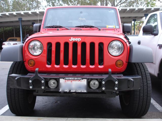

I attacked the hooks. I just bought some metal that is 3/16 in thick that I plan to replace the stock metal with.
