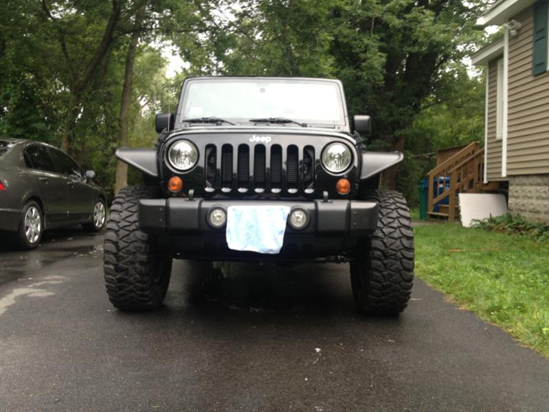

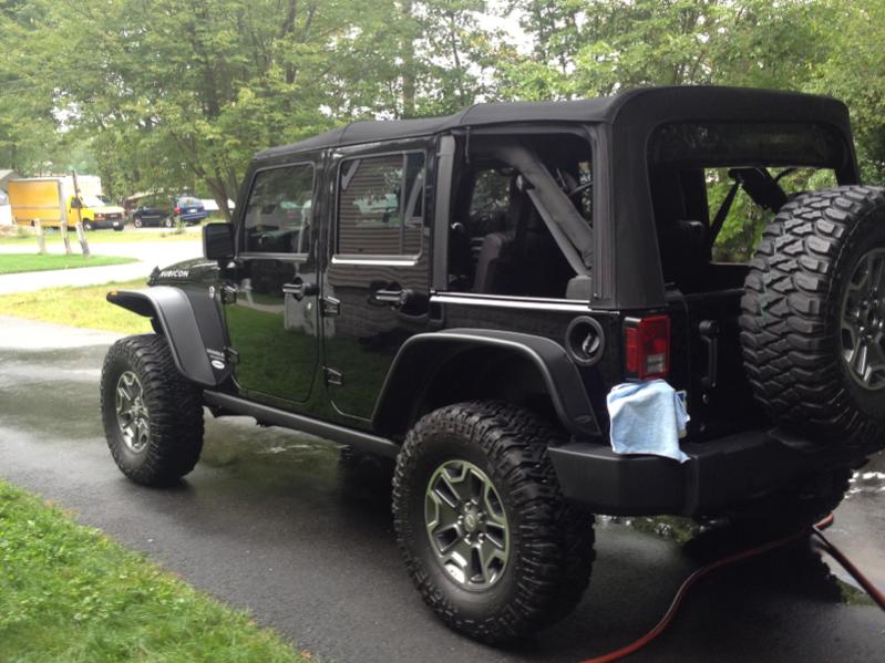

Love these fender flares now that I am complete. Not gonna lie took me a solid 6 hours of install but all in all loving them. Just a heads up anyone interested in these when wiring LED marker lights remember white to black for proper wiring. Learned that the hard way luckily i could remove fender liner and get to wires easy enough. Test b4 final installation to save yourself the heart attack
Only 6 hours? It took me over 8 hours, lol. The hardest part for me was cutting the inner fender liners. I was so afraid of cutting that first one too much, I didn't cut enough using a hacksaw, then had to go back and recut. After the first one, the sawzall took care of the other 3 much quicker. Now that I've done the install and know what I'm doing, I think I could do it in about half the time. It's not difficult, but it is tedious. Fortunately, I had already heard about the black to white wiring for the side marker lights.

Very nerve racking ripping apart a brand new Jeep and making permanent mods. Had a hard time falling asleep last night thinking I had to pull front fenders off to get at wiring. Woke up this morning and was able to access wiring through fender liner.

Sorry for bringing up an old thread but THANK YOU!
Thanks to this you saved me big time today, had the fenders on and no working lights. I was not happy to say the least, quick search and found this, switched wires and BAM. Let there be light!!
anyways thanks a lot for the help. Sure would be nice if the directions were a little better.
