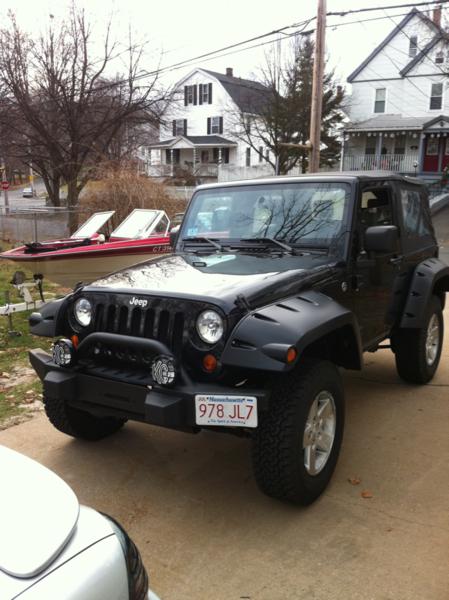

Here's mine with stock Rubi Rims

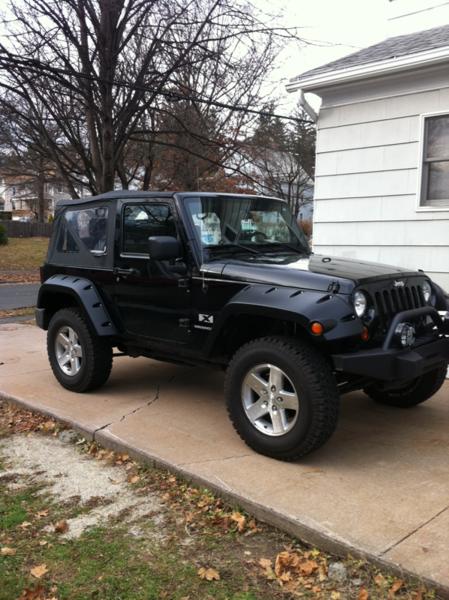

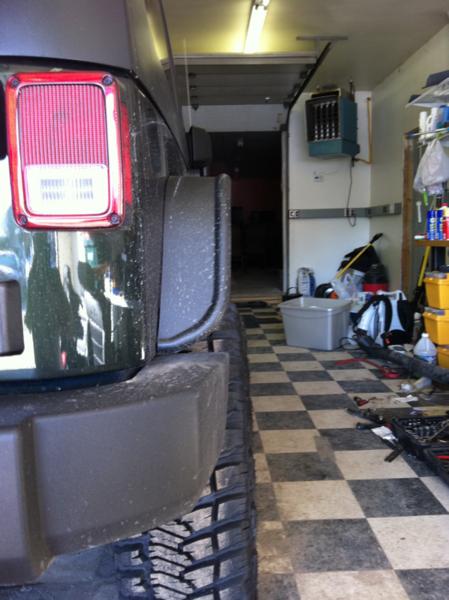

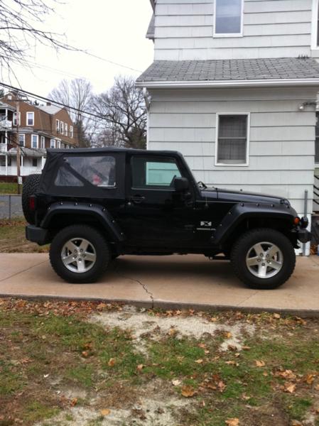

Here is mine with rubi rims, 265/70/17 BFG AT's and 1.5" spacers.. The flares clearly overlap the tires, but it doesn't look all that bad.. When I get new rims with less backspacing, and 35's it will be perfect IMO.
ID:	128481   Click image for larger version
ID:	128482   Click image for larger version

Originally Posted by TheDirtman
He is asking for the pocket style not flat.
Sorry my bad!!
You have the standard rims and 1,5" spacers on each side, so 3" on the axle width? And still the tires are kept within the flares?
Do you already now how much backspacing you'll need to keep the rims within the flares?

The flares stick out noticeably farther than the stock flares did. My stock rims have 6.5" bs so with the spacers it makes them equivalent to rims with 5" bs. I'm eventually getting 16 x 8's with 4.75" bs and 35's, so that should help make it look more proportionate. FYI these flares are HUGE. Without spacers or rims with low enough bs do not expect your wheels to surpass the flares. It's an acquired taste, but I like it and am glad I went with the pockets. Makes my JK look different than every other one on the St, and I get nothing by compliments.
