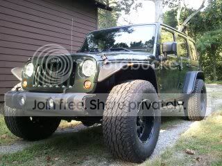

Here is a pic of setup with stock tires

I was told from my tire guy with the open wells you can run 33x12.5s no problem just make sure to run a rim with a 4 - 4.5" backspacing and you will have no problems.

you can pretty much run 33's without any lift or fender modifications. with a leveling kit and flat fenders, you should be able to run 35's so long as they're mounted on new wheels with less back spacing or running wheel spacers.

I ran Bushwacker flats and 37's for about a week with a stubby front and rear bumper on my '12. You will have to trim the pinch seam for sure, it did rub some on bumps and I would not off road it but it looked sweet and I liked it a lot. Plus it handled great with the wide tires. I feel pretty sure you could run 35's no problem, just may have to trim the pinch seam and get some bumpstops, it would look sweet for sure.
