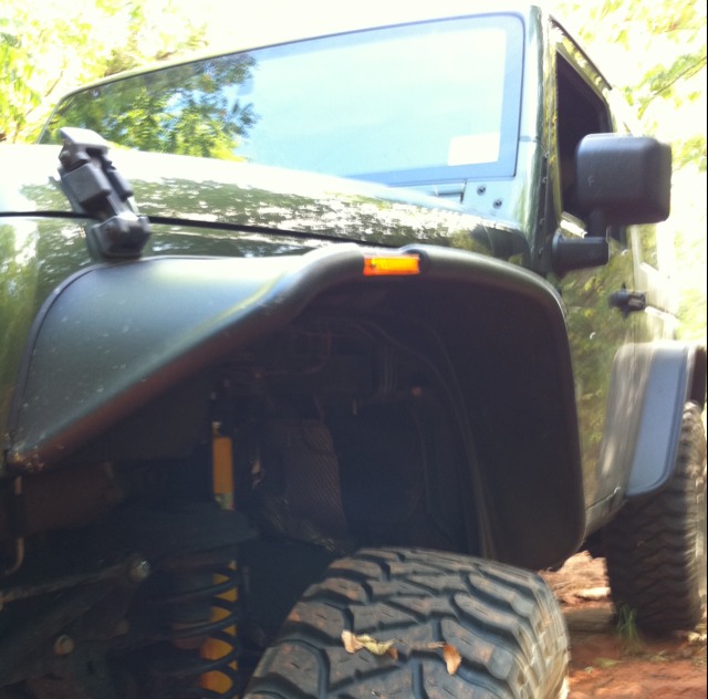

Got them on! Easy install except for the 104* heat outside.

do they come with liners?

No, they have instruction on how to reuse the stock ones. I haven't ran any for the past year so I didn't put mine back in.

On the bolts with the nylok nuts use a bit of dishsoap or oil as they like to bind up.
They do not come with liners you cut and reuse the existing ones.
