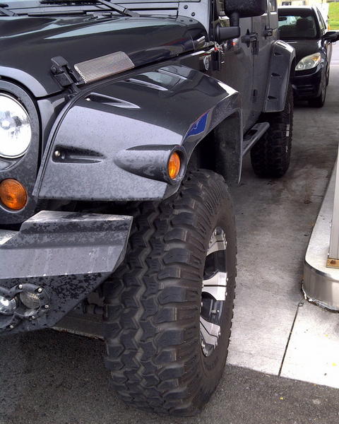

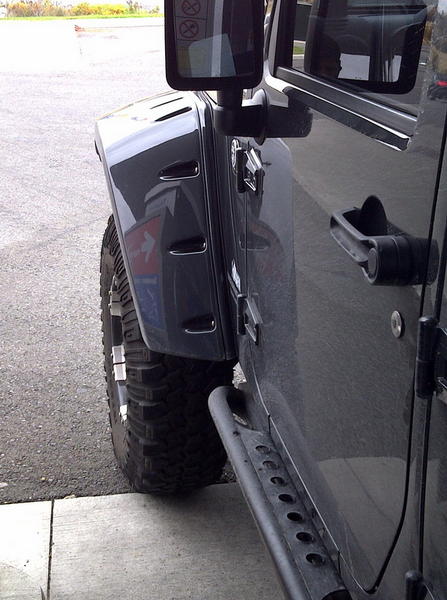

Here's couple pictures of the flares. I'm running 35x12.5 with the standard JK backspacing. The wheels are Dick Cepek DC-1's.
I find they have plenty of coverage but if you're lifted, the fine spray that kicks up from the bottom 1/4 of the tire will still fly up to your door from under the bottom of the flare. The only thing that would cure that would be front mud flaps.
Hope this is helpful.

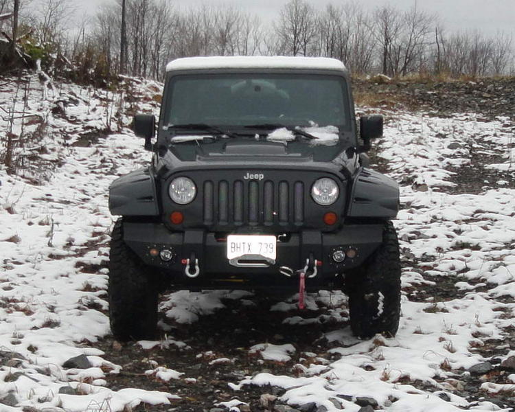

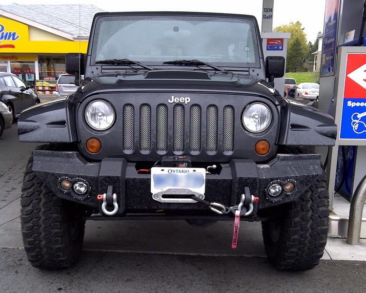

Hey trooper and shots from farther away

So those wheels have a 4' BS right?
They look almost in line with the guard, so if i ran a wheel with a 4.75 BS the tire would prob sit around 3/4 of an inch inside the guard.
Old Oct 30, 2010 | 07:52 PM
Snowstorm.Trooper's Avatar
Posts: 79
From: Ottawa
No, I believe standard JK backspacing, at least on the 4dr Unlimited is 4.5 (and change). I think you'd still be inside the guard with 4.75. Maybe its the angle on the pictures I took but I've got at least an inch of coverage to spare.
Sure..... its not a great picture but hopefully it helps.
