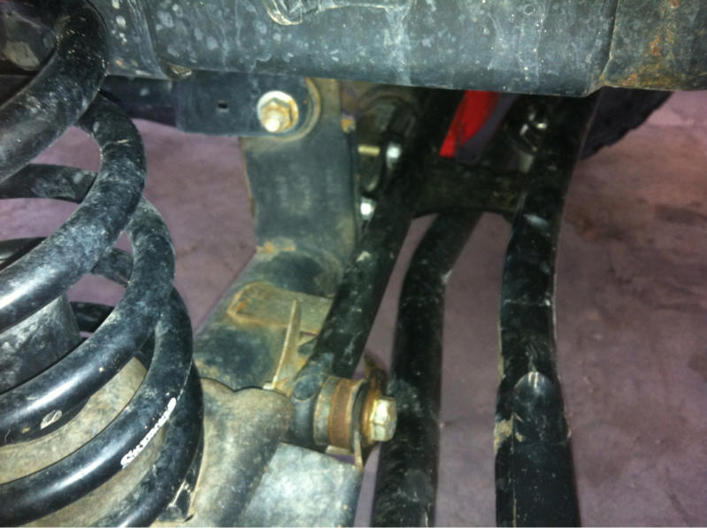

Here's some pics...
Attachment 421060
If I did a 1" body lift would that warrant the rock crawler steering package? Lol I was thinkin about doin it anyway

do what photoshop above said. rough stuff has a tie rod for about $150. can't beat that. pick up an oem draglink because they're fine... you can get them for free. i threw mine away.
get that stuff done on the cheap and dont ever let your friend drive again.
and you don't need to run a stabilizer. if you really want one, buy a cheap relocation bracket and get a stock oem take off for free (i threw mine away) and flip it to the top so it doesn't happeen again.

Sorry, but a BL won't help with getting your suspension height to 3.5", the new draglink needs the added space in there for it to fit and not bump into anything else. Love BLs personally. You could get a 1" coil spacers, unless you've got a 2.5" BB (can't remember), don't want to stack those.
Ruff Stuff's tie rod is good, or you could go OEM again on Tie Rod. Factory Drag link is good to re get. Get RC's Adj track bar since you've got a 2.5" lift already.
