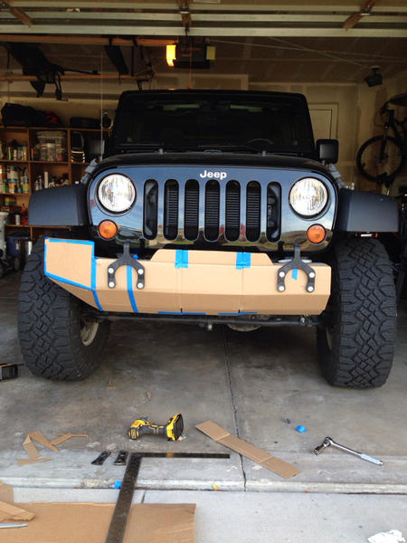

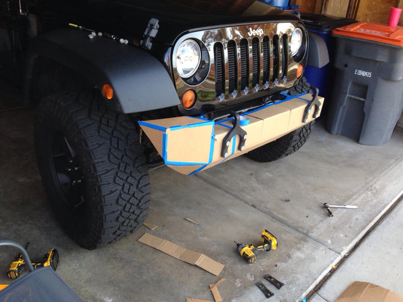

Hey all, I am looking for some feedback on a front bumper that I am going to attempt to build. Any design considerations that I have missed or am leaving out? I am in the early stages of putting this together and thought I would hit you all up for anything I may have missed. I do plan on adding some high lift jack points, a winch, and some tabs where I have the stock hooks in the mock are located. Thanks!

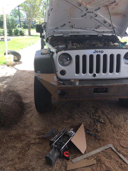

I think your on the right track. I wanted to keep my winch fully recessed/hidden in the bumper. I used a piece of channel for the front so that I had a flat spot for hi-lift points. I also chose the use the stock mounting hooks with the d-ring tabs in the center that way if my shackles are stolen I still have a place to hook. Feel free the ask if you have any particular questions.

I'm likin' it so far. make sure you take good measurements & post them here. I like the look of a stubby but I don't trust people in front of me enough to do without the front wheel protection. I'll give up the approach angle rather than safety any day,, Keep Wheelin'

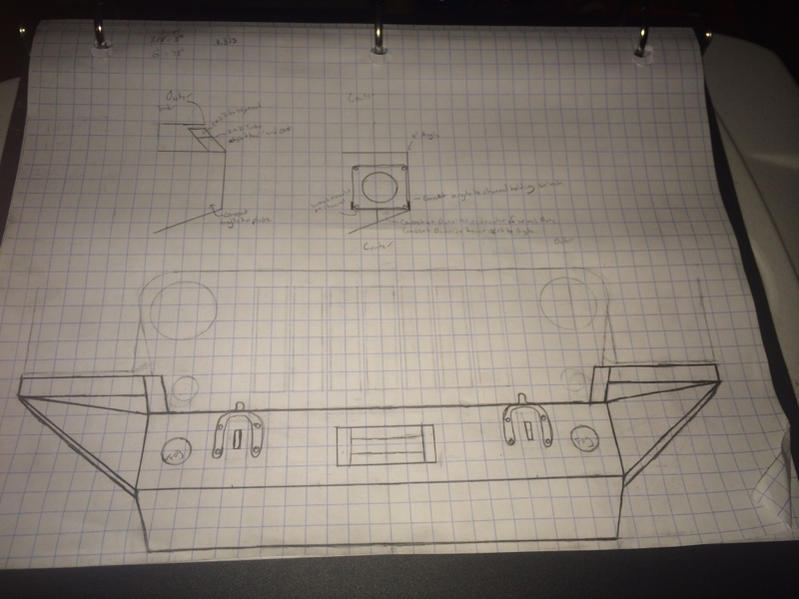

Started with a to scale drawing to get my head around the way I wanted it. Had a piece of channel that was 48" long that I bolted up to the front of the frame horns, verified a few measurements and then made some templates. The winch mount is another piece of channel welded in the back, with some gussets keeping it from twisting in any way.
