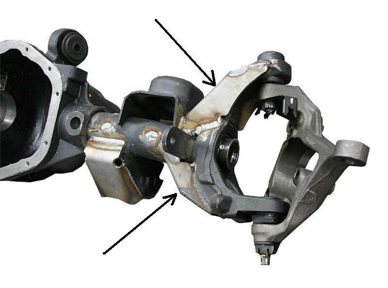

Do the Dana 44s really need reinforcement? Also, does anyone have a pic of exactly what is being done to the axle?

I don't have a pic but what the gussets do is to add further triangulation between the top of the C and the axle tube.
Thanks,
Flash
The welder's technique will prevent heat damage to the axle and ball joints.( weld a little here, weld a little there, go back and weld a little more here, etc., etc...

The front D44 tubes are not as think as the rear D44. The front D44 tubes are actually the same tube thickness as the D30. These thin tubes are prone to bending. Also the Cs are longer than previous D44 versions and more prone to bending. So long story short the front axle housing is not up to the task and should be reinforced.
