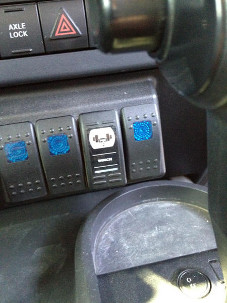

Thank you, for what everyone was charging for Jk specific switches, for a little more I have a proper sports cage and I have my switches above me and out of the way.

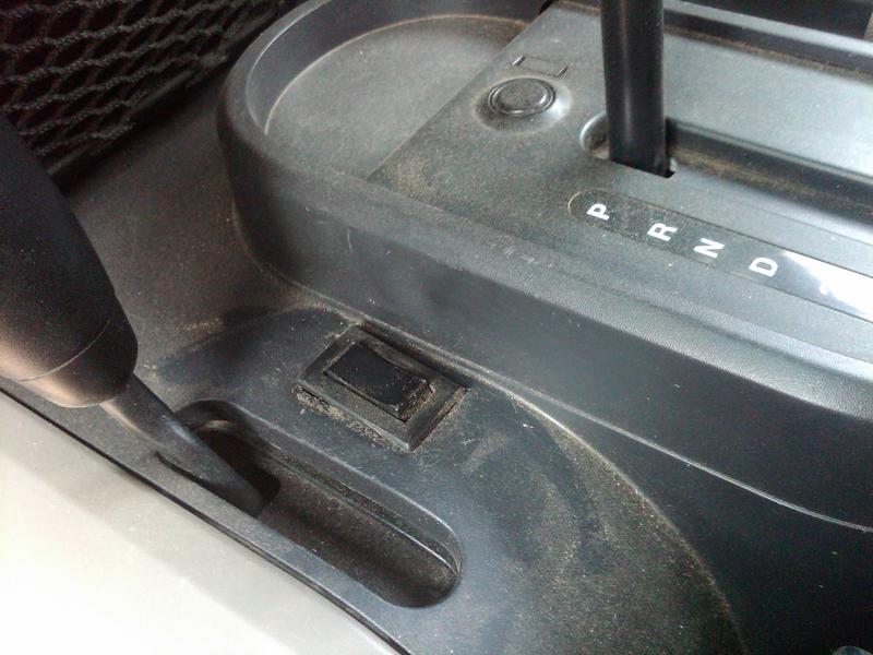

here's mine, waterproof momentary toggle switch, it's neutral in the middle push down on the forward end for spool out/ push down on the back for spool in. when you take your finger off it returns to the middle or off position.

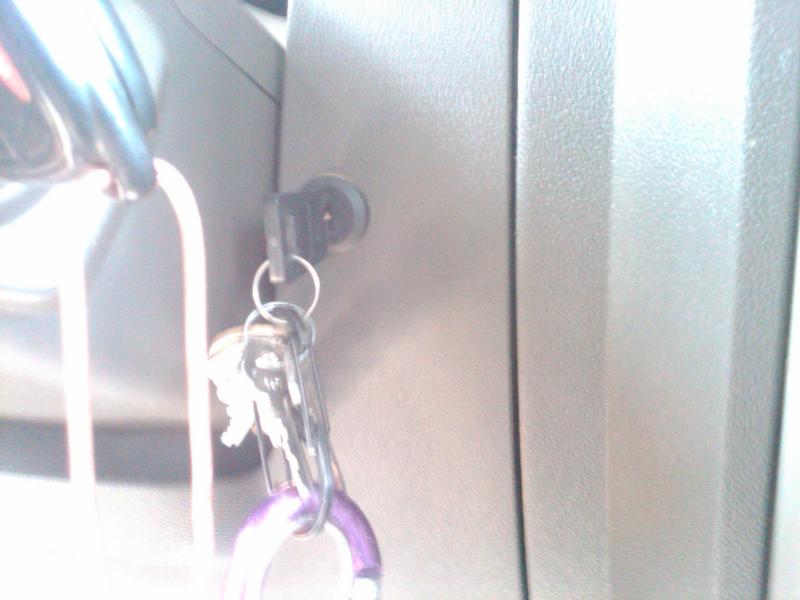

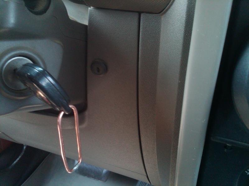

I ran the primary power supply through a small key type switch so that the interior switch can not be opperated by others (like my 8 year old) and suck the cable up into the fairlead housing.
