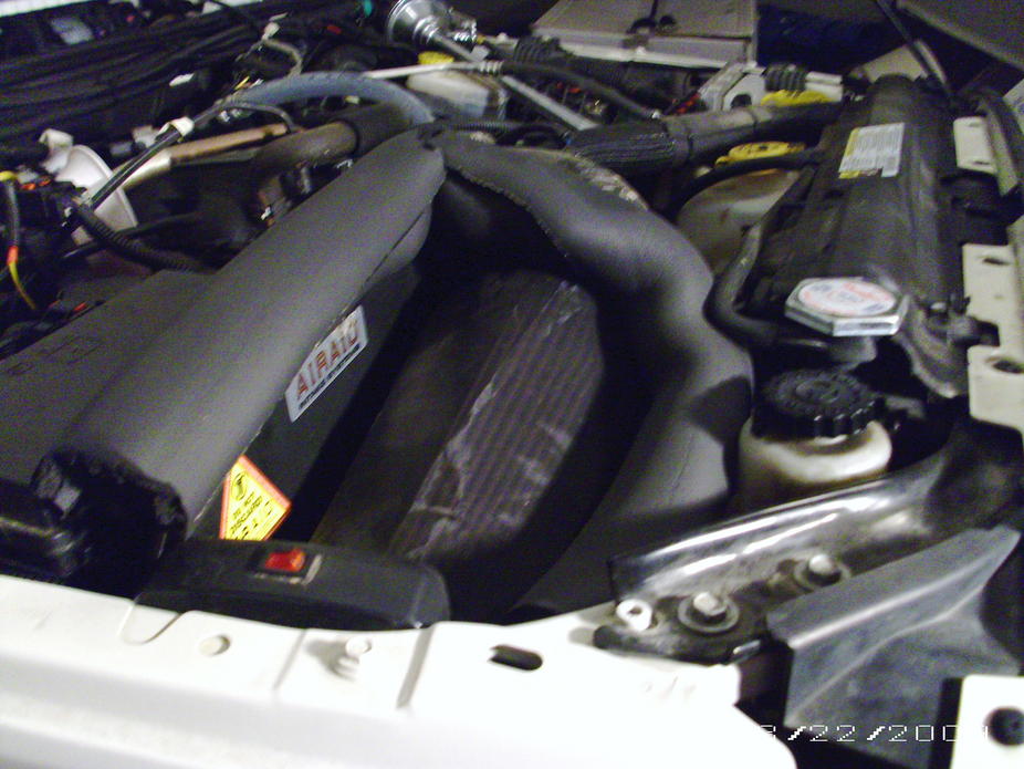

Just a suggestion, get you a pre-filter( helps shed water and keeps alotta dust out), and also get some pipe insulation to run around the top edge for a better seal against the hood. I took it one step further and added a homade splash guard to the front and siliconed at the bottom. I've had no issue going through reasonable mud and water, the filter stays dry.

Whats the little red button next to the intake?

I am wondering the same thing

It's an led light switch. They makem for truck beds with magnets on them so you can stick them anywhere. I gotta few scattered all over the jk in case I need a flashlight I don't have to hunt.

I'd like to see this splash guard you speak of....

Basically I cut a piece of roof flashing( orginally used a piece of fender liner) to fit in the front spot where there is nothing. Wedged it in , abit of silicone and it hasn't moved in over 10,000m. If you look at the pic, the front piece of pipe insulation is on the homade guard in front, the ins is not just laying there. I made this for the front because a good bit of water can kick up through that spot.
