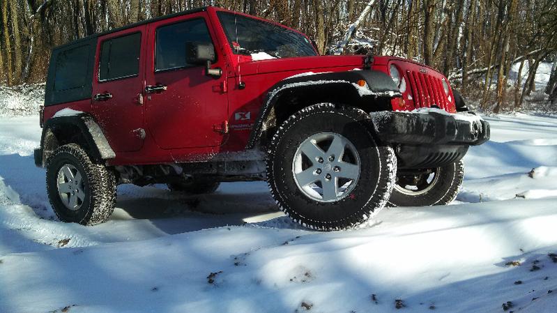

Old Feb 7, 2013 | 01:08 PM
madmike232's Avatar
Posts: 445
From: dearborn MI
I run 315/70/17 stock rims not wheel spacers and a 2 inch rancho lift that only nets 1 inch in the rear. Yea it rubs a little but that's because my rims don't have enough back spacing. I do go off road and am always trying to park on to of stuff and never rub on anything (going straight) I would not do crazy flexing untell you get some after market fenders or trim your. I just keep my links connected and I am all set.

Old Feb 7, 2013 | 01:12 PM
mpkelley20's Avatar
Joined: Oct 2009
Posts: 1,381
From: East Bridgewater, MA
One more thing....I actually get rubbing withy 35's and 3.5" lift. My Rock Krawler lifts have crazy travel and I either need to adjust my bumpstops, or the more likely scenario, trim my flares. Not sure the "flexy" Rough Country is but I think you will be ok.
Here is my jeep rubbing while under some rather large articulation
