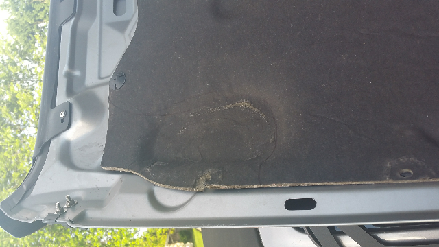

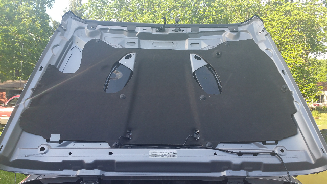

I had similar issues...everytime i roll the gas on it would fall on its face and go to limp mode. I changed Throttle Body, cam sensors, cam solenoids and map sensor and air filter. Worried dealer wouldnt touch it and i was stumped, i finally noticed the under hood pad was very wrinkled at the airbox location. Sure enough the stock airbox was sucking the pad down and cutting off my air supply. So after a quick trim all my no power issues were gone. The before pic is after i pulled the pushpin and noticed the hole was slotted and pad was shifting just enough without pulling it out completely from pushpin and blocking my air box on a medium to hard acceleration. I couldnt even drive around slow traffic on 4 lane roads, as it would fall on its face into limp mode.
Not sure if thats your issue but an easy check.

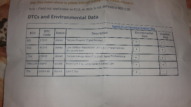

Heres a pic of my codes. I was getting the air restricted code...which i couldnt believe that was the primary issue and was thinking it was the byproduct code or aftermath of it going to limp mode on a good acceleration and getting a rich issue as it burped the unburnt fuel. I was wrong as i found out it was clearly an air issue. But the other codes were what threw me for a loop.
